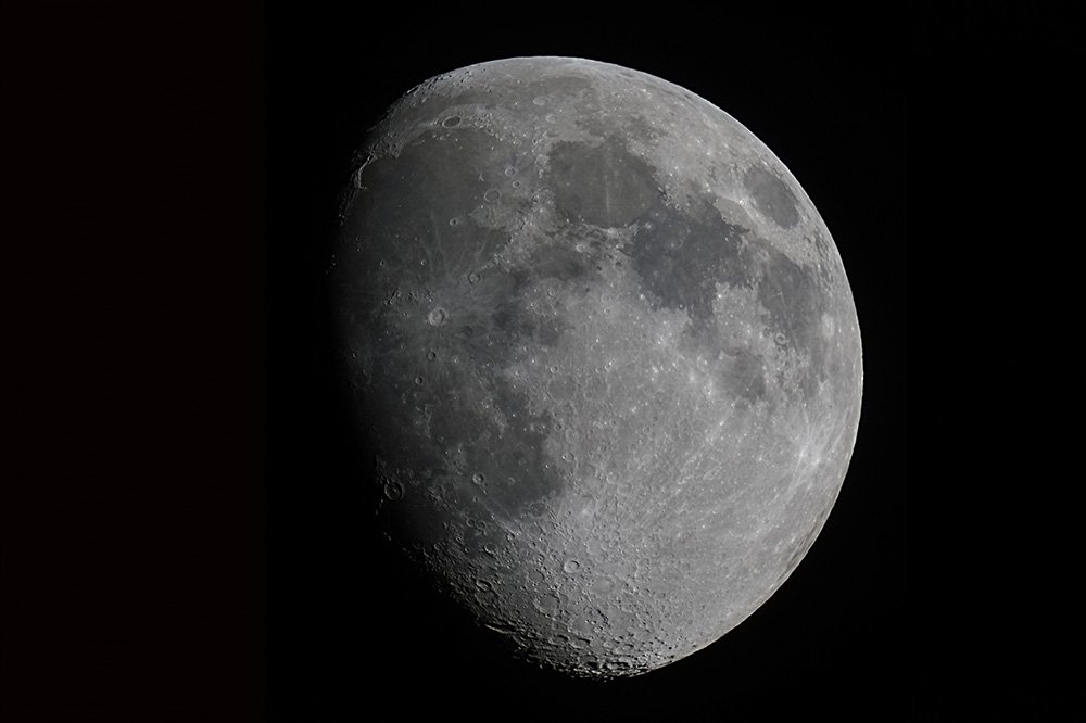

To photograph the moon with its apparent diameter of about 30' format-filling the setup is almost ideal, the moon fills about 75% of the horizontal image area. Also the sharpness is sufficient to see some nice details.
Moon, 10.8 days old, F13 ISO-100 1/60s

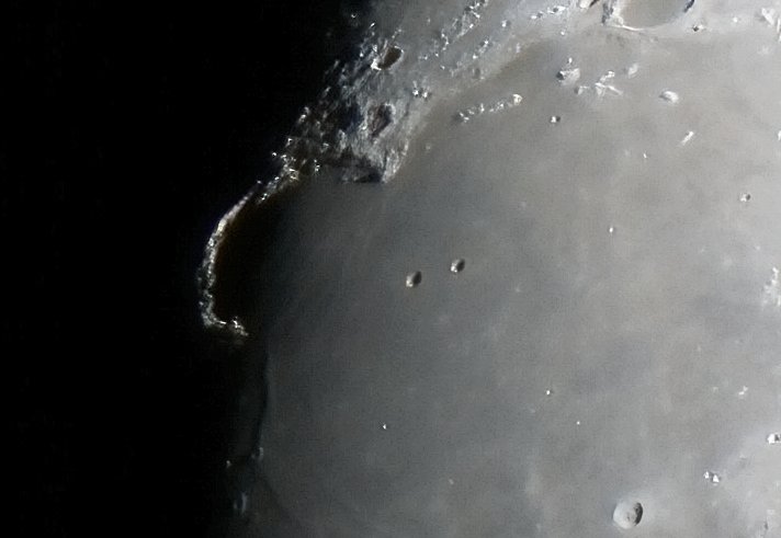

Crop of the so called golden handle

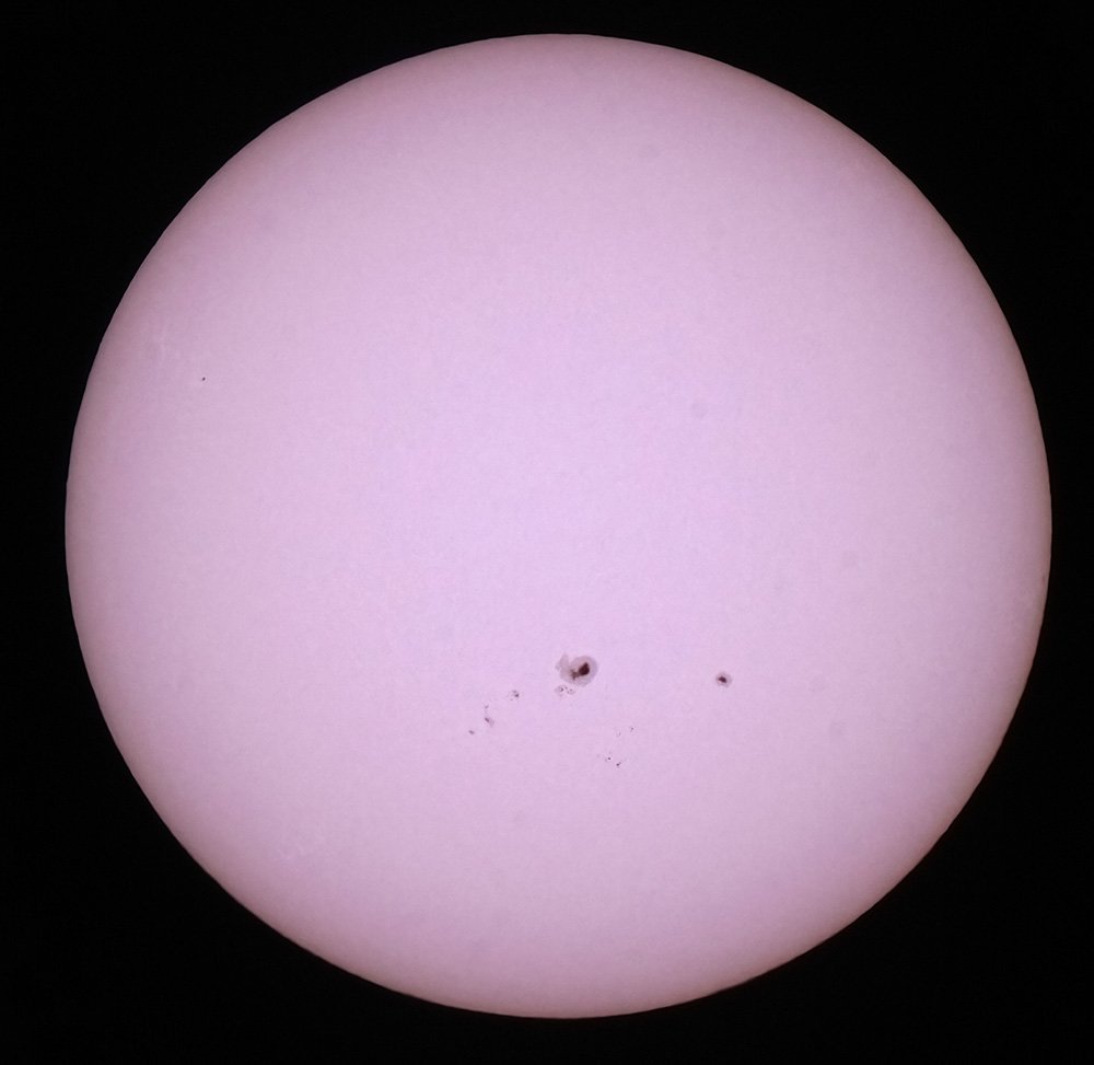

Since the sun has almost the same apparent diameter as the moon, the same applies to solar photography as just mentioned, except that a suitable solar filter (in my case a Baader 5.0) must be used!
Sun with several sun spots, F19 ISO-800 1/1500s

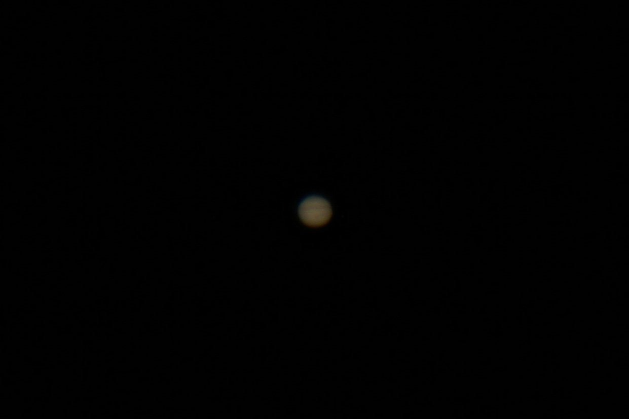

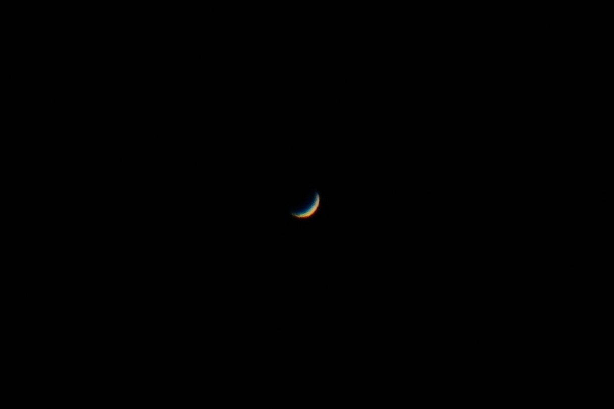

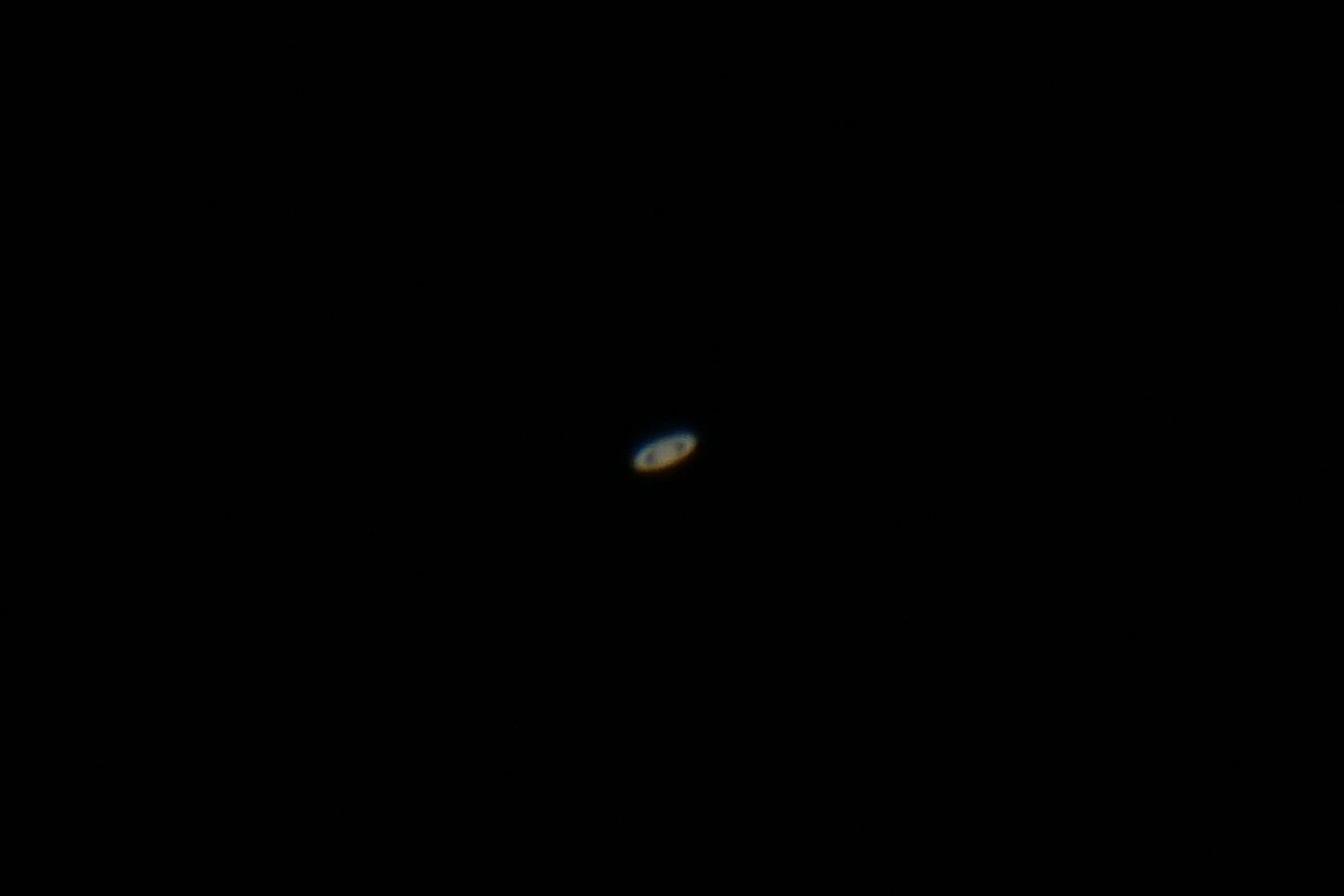

Bright planets can also be photographed with this equipment. However, the lens with its 95mm diameter is not fast enough and the achievable focal length of 1800mm is not long enough to see details.
Jupiter, F13 1/30s ISO-100
Saturn, F13 1/15s ISO-400
Venus 270 days old, F13 ISO-400 1/1000s
