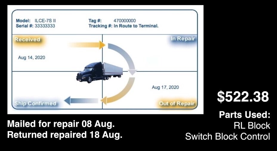

Used Precision Camera twice. Once for a stuck shutter assembly (Think of horizontal blinds in the lowered position and having the cat jump at the birds at the feeder just outside the window) in 2018 for $260 something and the last time for a menu system that kept rotating through menu items, image review, and time zone selections randomly on its own (2020). No complaints to speak of. Likely a misunderstanding of 500 skins just to look at it.
You may be able to shop the thing around for estimates ($90 is a typical 'look-at' fee around here to evaluate it} but how many of those you willing to pay for before you decide to get it fixed at a price you seem is reasonable?
As someone who makes money with it $522 was doable to get mine back in 10 days time. (Hit their doorstep Aug 14 & out of repair Aug 17!) Didn't want to waste three weeks ferreting out someone who might do it for $325 after waiting for the parts to arrive. I'm certain PC is in the priority pipeline for original Sony parts since Sony itself recommends them.
