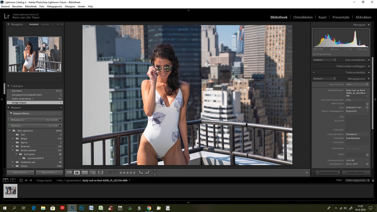

This is how the darker picture shows up when imported in lightroom cc classic (latest version) I don't see much wrong with it. No pp done by me at all.  The histogram is just fine.  The beach picture was fine after lifting the shadows slightly, to bring out the details in het hair.  It just shows you how different programmes give different results.

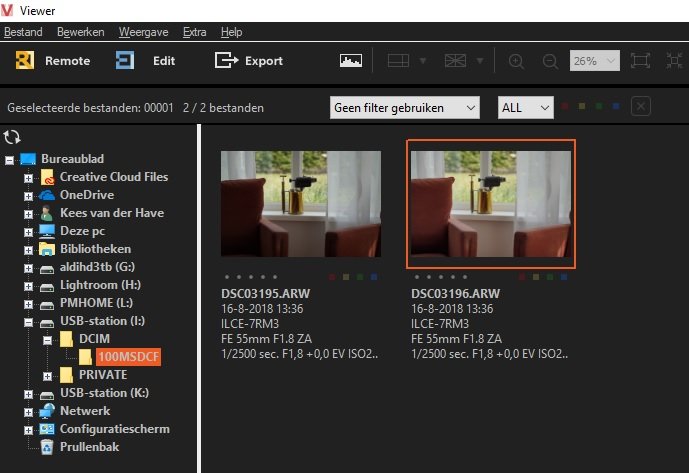

I think what happens is that the camera applies a different conversion from raw to jpeg by switching  DRO on or off.  In fact, all we see is jpeg, as far as I know raw cannot be viewed. Attached you see a screenprint from the Sony viewer, looking at 2 shots on the card in the camera. The left shot is with DRO off, the right DRO lv5.  All other settings are the same. You see this same effect through the view finder and the screen. However, as soon as I import both raw files into lightroom (and lightroom converts them to a viewable format, not the camera) the difference in dynamic range is hardly noticeable. However, the DRO lv5 file has more LR possibilities to recover the shadows. So, is the camera doing something to the raw files when altering DRO settings, or is the camera doing something in the conversion process depending on the DRO setting?  I guess I should have said that DRO settings are available when shooting RAW, not that it effects the RAW file, because that I am not sure of.
Edited by Lescatalpas
Very interesting. I’ll do a similar test using C1 this weekend.  Can’t say I understand how setting dro to 5 increases a raw file’s ability to be manipulated in LR. If this is the case then I assume the raw file is impacted when dro is enabled.
I agree, and the differences in the dro lv5 file are minimal. So it is perhaps a slight change in light between the 2 pictures.  I can't see the raw file being manipulated by the dro either.  What I have learned from this conversation and the tests I did, is that the DRO setting definitely effects what you are seeing on the camera (and perhaps being misled by it!) but not much difference on importing into LR, if any.
I don't know the specifics about how DRO works so this may be completely wrong, but is it possible that the sensor's sensitivity is being changed on a photosensor by photosensor basis by the DRO setting.  For example, if the camera evaluates the overall image and finds that the range is beyond what the camera can handle, would the camera increase/decrease the effective iso on particular photosensor?  If that is what is going on, then I'd expect the raw file to look very different when capturing a high dynamic range image such as your example assuming the window is very bright.
Maybe so. But we don't see the raw file, we see a conversion, a conversion done by the camera is shown on the screen and viewfinder, and apparently we see a different conversion by LR, C1 or any other program. It's confusing.
3
I'm a bit confused.  I checked and have the newest versions of Lightroom, Bridge, and Capture One.
When I import the photo into Lightroom like you did, I do not see the above result.  I see the dark shot.  I have attached the view I see in all the programs along with a quick edit I did to show what I saw in camera.
