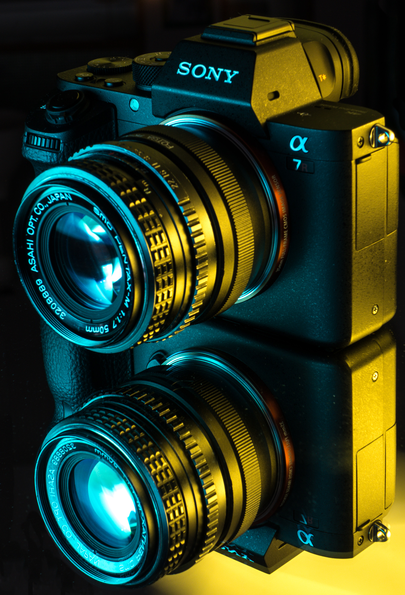

I read many enthusiastic reviews on Pentaxforums about this prime and since it was generally cheap and has the same focus direction as my other Nikon Legacy glass, I gave it a try. I found a copy for 30€ and the seller assured me, that it was optically flawlessly working and just had some cosmetic tokens of time.
Well so far for seller’s honesty. The lens came to me with fungus behind all elements, I was unable to turn the focus to infinity and it was taken apart unprofessionally to declick the aperture. The small metal ball that served as friction point for the aperture ring was missing entirely. So after taking this lens almost completely apart twice over the course of 6 hours, molding a substitute ball for the aperture clicks from hard plastic and cleaning the elements with distilled water and q-tips, I now have a clean, clicking and focusing lens.
So with all the good things I have to say about this lens in the following, you have to keep in mind that this lens was in really bad shape and good copies may perform even better than mine. I use a cheap cnc-machined adapter that only acts as an extension tube and has not moving parts except for the locking pin.

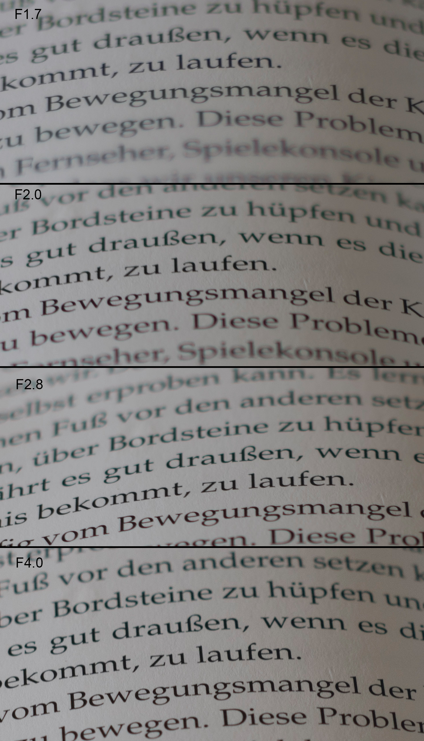

Sharpness & Contrast

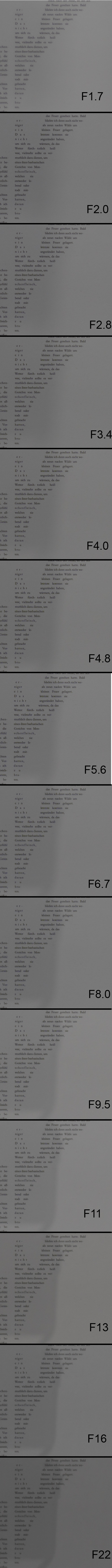

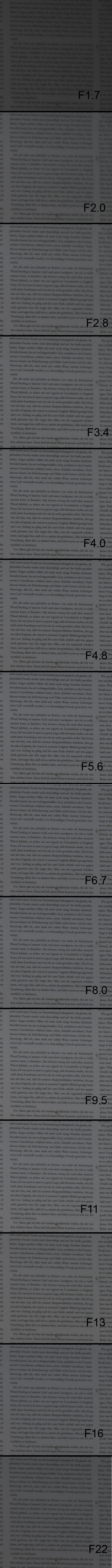

Center sharpness is good from F1.7 but the corners need F3.4 to F4.0 to catch up. Contrast makes a big jump from F1.7 to FF2.0 and improves only gradually from there on. Diffraction shows it’s first signs at F6.7 and is noticeable above F11 in regards to sharpness. Contrast decline starts at F9.5 due to diffraction.
For the corner crops I chose the sharpest corner as I am not very confident my test setup was very precisely aligned. The the corners having different degrees of sharpness could also mean that my copy is decentered in some way. I need to check this at an infinity target to be certain.
center and cornder crops:

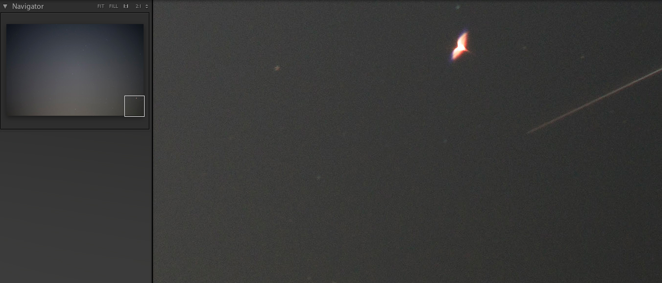

At F1.7 and F2 there is a small amount of tangential and a fair amount of sagital astigmatism in the corners. This is unfortunate for astrophotography as the point shaped light sources make this defect easy to spot.

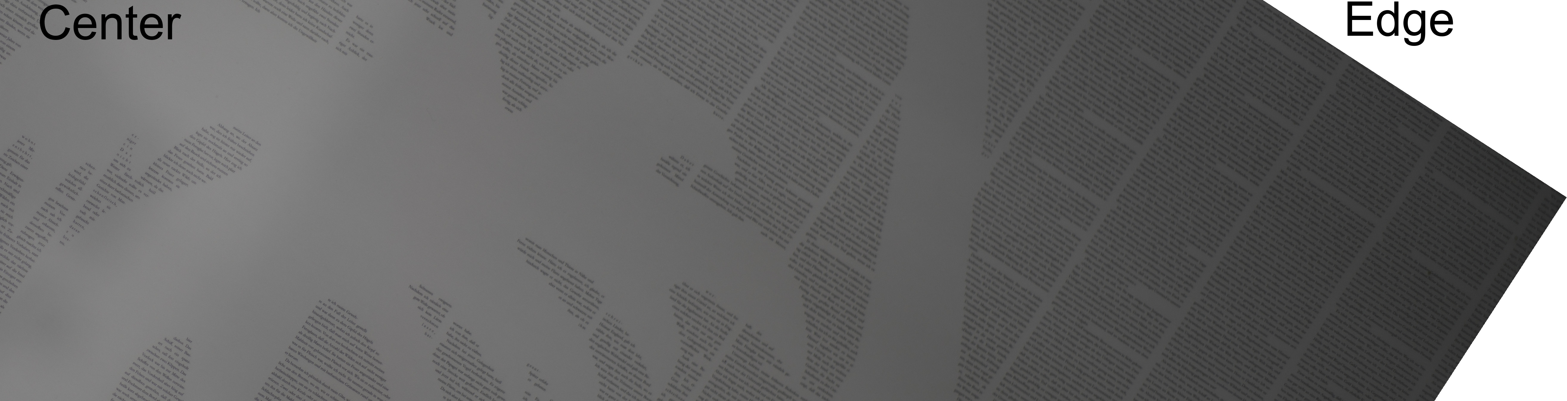

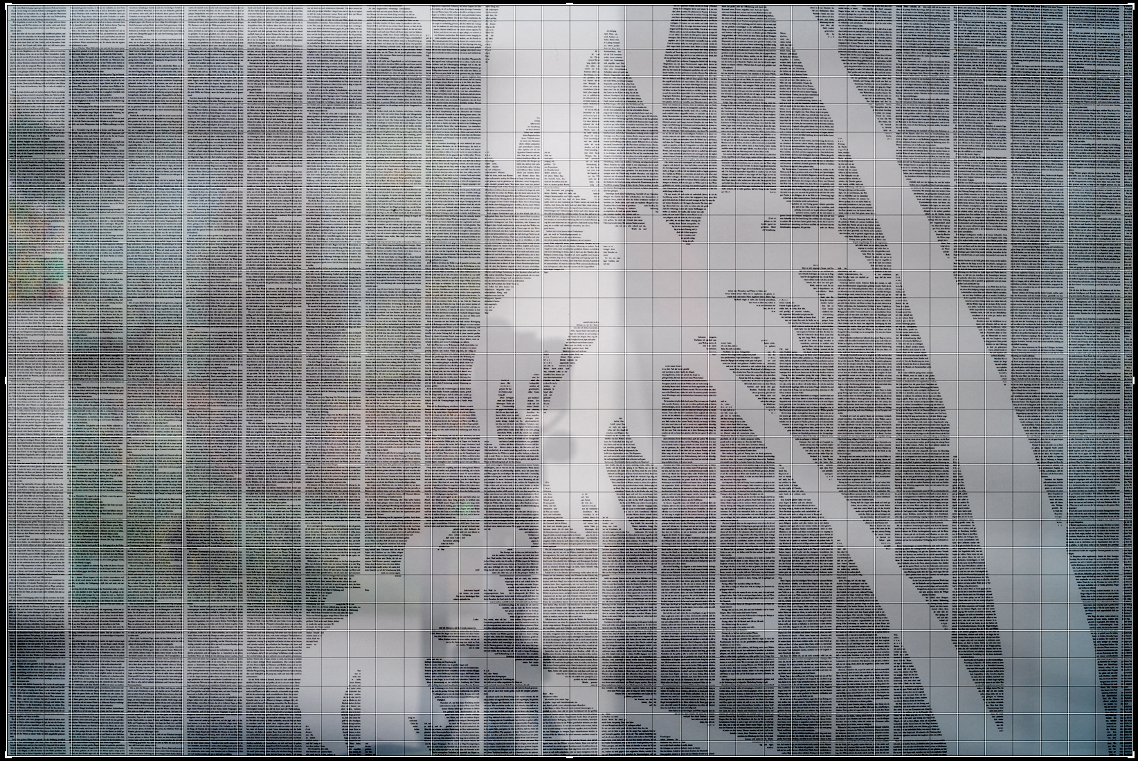

Distortion in general is well controlled (very minor barrel distortion) but I think there is some curvature of field, as flat surfaces have not a linear sharpness degradation from center to edge but have some radii (if that is the plural of radius) that stand out in unsharpness.
Grid vs. distortion:
Full size radius to show curvature of field:

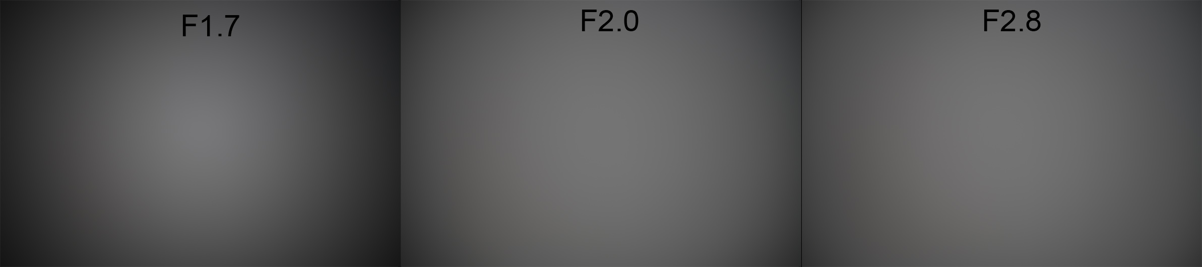

Vignetting is mostly gone by F2.8.
