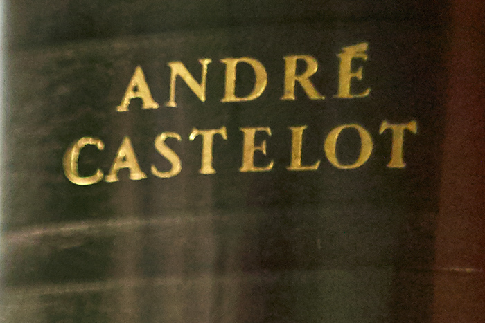

My A7s modified by Kolari Vision works fine with both 50/1.4 asph and 35/1.4 FLE lenses. Corners are rather soft at f/1.4 on the 35/1.4 FLE though but they don't look signicantly sharper on the M240 to be honest. Here A7s mod with 35/1.4 FLE at about 0.5 metre, f/1.4, focus on "Castelot". FWIW.
