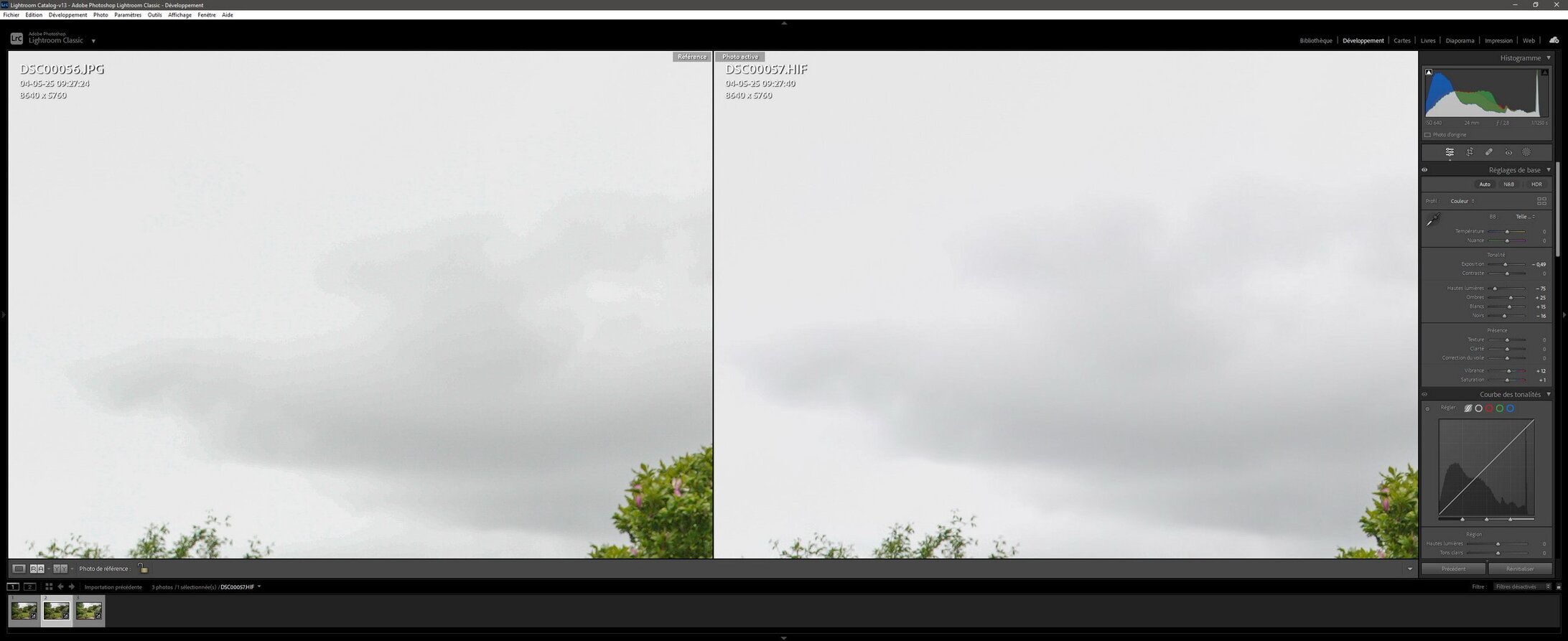

I just bought a A1 in 2nd hand and would like to shoot in HEIF. I'm talking about still pictures only, not movie.
There are 2 options in the menu, either 4.2.0 or 4.2.2
I watched tons of video and nobody seems to agree with the bits depth of this format. Some say both are 10 bits while others pretend only 4.2.2 is 10bits and 4.2.0 only 8 bits.
So ? what your guess about it ?
From my test I could say both are 10 bits but I would like confirmation
Thanks in advance
ok thanks for your answer. But how could we explain I have a smoother gradient on HEIF than JPEG if they're both 8 bits ? I'm sure the right picture is 4.2.0
I think color profile in LR is at fault here. I think for JPEG it uses sRGB and sRGB is 8bits afaik, HEIC is rendered using Display P3 so somehow that gradient is smoother because 8bits are displayed on a 10bit profile?
