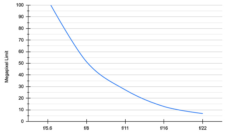

I found an interesting graph here, showing the maximum megapixels on a fullframe sensor that a lens can resolve at a given aperture, due to diffraction:
What you see is that beyond f/11, any modern camera with 24-30 megapixels will show image degradation when stopping down, unless you value greater depth of field over absolute sharpness. Apertures beyond f/22 will result in a blurry mess on any camera, so it doesn't make sense to allow for smaller apertures. If you really want great depth of field, better do some focus stacking at larger apertures.

Also, the format size has to be taken into account.  Larger formats, such as 4x5", have less of a problem with diffraction at f22 or greater because they don't need to be magnified as much to produce the same sized print.  Many large format lenses have f-stops to f128.  Smaller formats, on the other hand, have a bigger problem with diffraction --at f16.
That's why I said:

At F22 nothing is sharp, so it doesn't really make sense to talk about 'the range of sharpness' here.
While diffraction is a concern, there are lots of full-frame lenses, especially telephotos and macros, that stop down to f32, in order to increase the very thin DOF at high magnifications.  Sometimes, DOF wins over diffraction.  And, just like DOF -- which is not simply IN-focus vs NOT-in-focus -- diffraction is a gradual scale, too.
