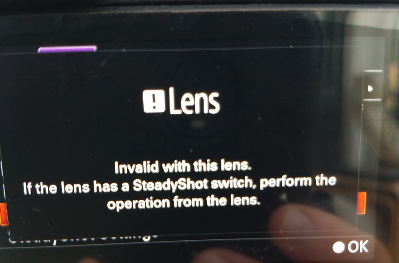

A6600 with mc-11 and sigma 150-500 for canon EF, menu shows steadyshot greyed out and off, irrespective of whether OS set to on or off or AF or MF. Presumably lens is not recognised and so IBIS is off?
Edited by Random Castle
Add pic
Likely it's a failsafe for the reason I described in my earlier post: to prevent double vibration compensation.
