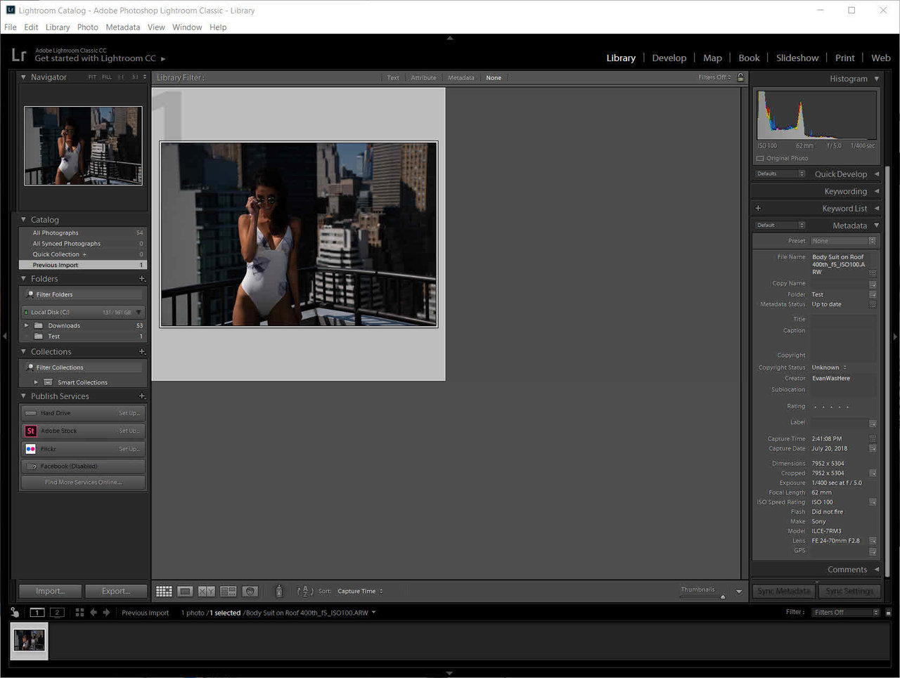

One thing I noticed, is that your "Quick Develop" is set to adjusted.  Do you have a filter that automatically applies to the image?

I'm very confused though why your lightroom opened the shot up with full brightness and I've tried on 2 separate computers and got the results I posted.
