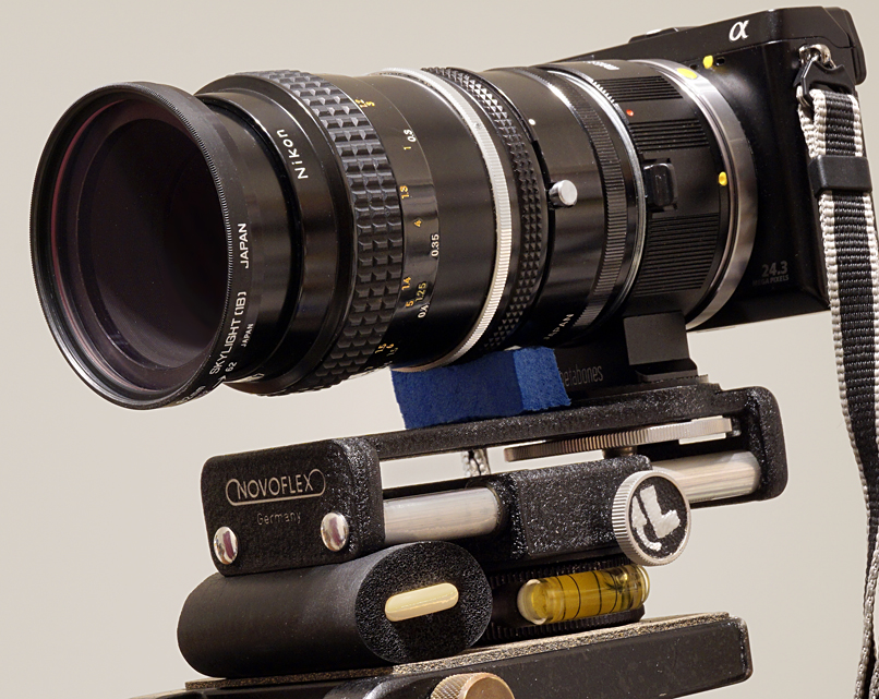

Equivalent FF FOV = 85mm is great for ordinary close
focus images, and for much closer work, the FOV gets
tighter due to its legacy focusing system. IOW, at half
life size the FOV narrows to be about 110mm [ = FF].
If I were using my modern 60mm the FOV would not
tighten up like that. So the 55 leaves a bit more room
to light the subject. And acoarst the focusing rail is my
salvation. I can hardly imagine working without it after
first deploying it decades ago.
The lens and focus rail are at least 40 yrs old ... maybe
50. The camera is "legacy" in digital terms, a Nex-7. It
doesn't have the high ISO ability of cameras just a few
years younger, but macro on Podzilla doesn't need high
ISO like my other interests require. And, at minimal ISO
there's no reason to deploy the a7II plus the longer lens
that it would need for the same result.
FWIW TWIMC etc .... rig also includes Metabones E-NF
converter and Globuscope thingy under the rails [yellow
bubble levels]. The Globus thingy raises the Novoflex so
that the drive knobs aren't crushed against the platform
on Podzilla, so it's required even if a camera has built-in
two-axis on-screen leveling. Acoarst Podzilla also has a
pair of levels, but the bubbles have grown kinda huge :-(
Thaz cuz Podzilla is also a legacy item ... an ancient Slik
that can manage an 8x10 monorail view, at 11 feet, in a
a stiff breeze :-)
Also, a skylight filter is hardly necessary to a macro rig,
but it's included just to irritate those who are irritated by
skylight filters }:-)
