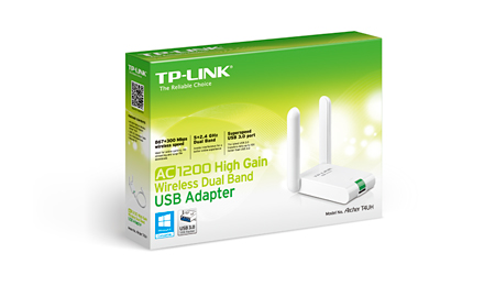

  3. If you can not use the Vision+ built-in link to the ground station app, you would need another solution to transmit and control telemetry data (e.g. battery voltage) which would add extra weight and interference with the WiFi signal. How long did the battery last in this configuration?
    We could use TPlink usb Powered dualband (5.8Ghz/ 2.4Ghz) wifi extender on the ground to extend range. Its connected to QX1. No extra device (weight) added on phantom. This could add another 100m. Remember range more than that phantom is no longer visible. The idea is to get quality photo/video by anticipating what the camera is capturing not to fly the drone km away. If we want to capture above cloud scenery, the signal may lost but QX1 will continue recording the video.

  • The QX1 WiFi range may be about 20-30 m, same for the smartphone. So you would need WiFi extenders on both ends. Don't now if this works - and you add even more payload to the Phantom. You still do not get telemetry data (voltage) from the Phantom.
    Actually QX! range more than that look
    we only need phantom to carry QX1 + Gimbal. Battery level is showing on the controller. Wifi extender is merely needed. Even if it does we only need one on the base station.

  5. OK, may be the WiFi range is 30-40m under optimal conditions. Still not enough.
