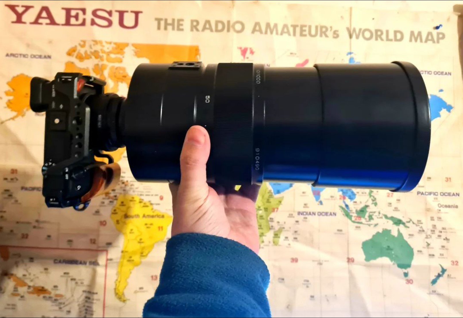

Many thanks. still weighing options up on this and will have a look after xmas... i am currently skint broke paying off a rash purchase of a mint boxed MTO 1000mm with filters and original box for my A6400... 🤣
