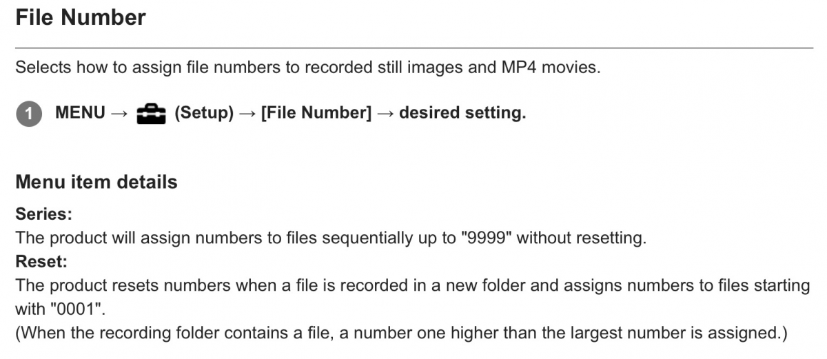

If you have this set to RESET then I think you will get the bahaviour that you stated, if you want the count to keep going up regardless of folder contents or format SERIES should give you want you want.
For the Sony A6500, I already have this setting set to Series.  As previously mentioned, I only have the reset issue on video file file names not photo file names.  I therefore conclude that the SERIES settings is only applicable to the Photos which is behaving as I would expect it in the file numbers continue from where the last photo was taken regardless if the SD card was reformatted.  Looking in the menu, I don't see separate setting options for Photo and Video unless I am missing a separate SERIES setting for Video File numbers.

I was not at home earlier so I could not confirm what you were getting. I have both A6300 and A6500, with both set to Series I can see that a format does NOT affect the count, it continues to rise even after reformatting. I can see the file number in the Play Index and it does not get reset to 0001. The folder name shows as 100, I have Folder Name set to Standard Form.

ok, thank you for the additional information and I now understand what is going on.
My camera is operating like yours but the nuance that I was not getting is that when it was stated that the series functionality only works for MP4 files, that means it only works when you are recording in the MP4 mode.  I realize that sounds obvious to some but where I was getting confused is that I am recording in the XAVC 4K video mode with also creates an MP4 file when I transfer the files from the SD card to my PC.  Evidently, recording in MP4 mode and recording in XAVC 4K mode that creates a MP4 file is not one of the same in terms of the output of the SERIES file number format.
Thank you for the help in clarifying at least how your camera is working.  I guess I still find it odd the the SERIES functionality does not work in the other recording modes that put out a MP4 file.

i just got off a chat with Sony support and it is so frustrating that this is working as intended but for STILLS ONLY.  The series function on the file number setting only applys to stills and does not work for AVCHD or XAVC-S HD or 4k.  How does that even remotely make sense for users that shoot video.  Very frustrating.
Further comment from support regarding my frustration with this intentional design, "I understand. However, we can guarantee you that this is not a bug but a restriction on the File Number function of the camera. We are sad to inform you that there is no firmware available to surpass or overcome this restrictions at the moment."
