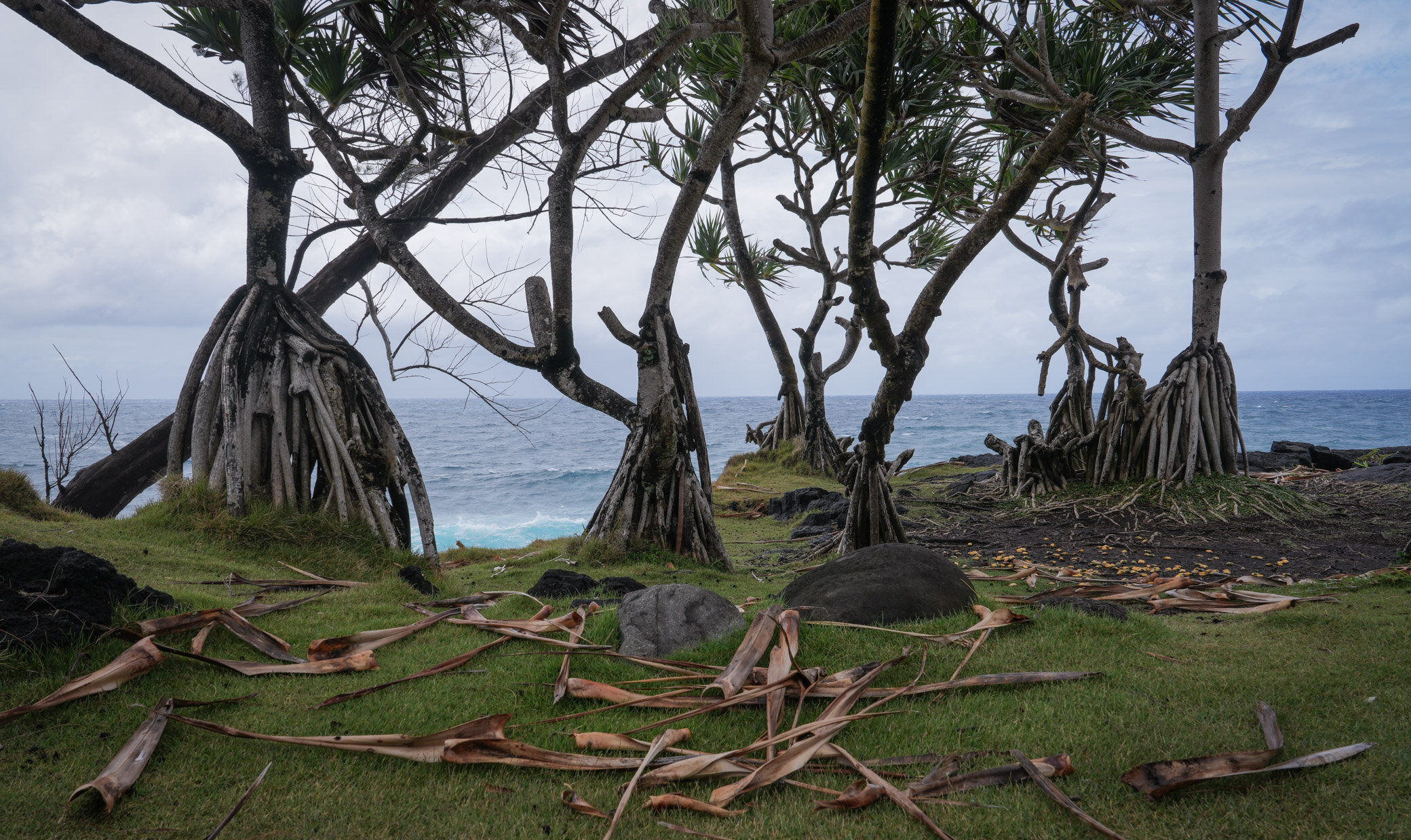

What's wrong in my new sony a7cr's pictures?
Hello, I am new to this forum, and even to Sony. I recently bought a sony a7cr which has incredible resolution, however I do not manage to get sharp pictures, which often look worst than with my old M4/3 camera. I would like to get an advice whether this could be due to:
  • the lens, I currently use the Sony FE 4-5.6 / 28-60
  • the autofocus, which I still struggle to master
  • the .jpg treatment of the camera (I haven't touched the default parameters so far)
  • the very high resolution which requires better technicity (which?)DSC09887.JPGDSC09831.JPG
Thanks a lot in advance for your help, I attach a few pictures.
First picture : image.png
Second picture : image.png
Well, as much as I hate to tell you this, that kit lens isn't known for being a very good option. It's really going to show its weaknesses on a camera with that much resolution.
Second, again with the resolution, shoot a faster shutter when possible, especially on those distance shots. 61MP isn't very forgiving.

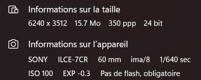

I don't understand the 1920 x 1080. Are you shooting in that resolution? That's a crop down to 2 MP. Are you sure the camera is set up properly? It looks like you're shooting in 1080P video mode. Shoot in the native 3:2 FF to start with.
What aperture are you shooting? Is that what 'ima' is? If so, you're hitting diffraction on that lens, which is going to soften things up.
Last: Is this a used camera or new? if it's used, have you done a factory reset to remove any old parameters and settings the previous user programmed? You should always start with a factory rest on a used camera.
As an aside, I can see dust on the sensor. You should clean it.
Don't be discouraged, it sometimes takes me months to get the most out of a new camera, due to all the settings and variations.

Lens: That is indeed a kit lens. The camera can be purchased by itself or with that lens. Sony sells it with several cameras. Any of the 28-70, 28-75, 24-70 etc. would be a vast improvement. I use Tamron/Sigma/Samyang extensively, along with Sony. If you want a decent lens with a wide range, the 24-105/4 is hard to beat.
Steady shot will help, and for the focal length you have the shutter speeds you used it should be good enough, but faster is better when learning the camera.
If you're trying to show us a problem, you need to upload as clean as possible. When you uploaded at 1080 you downscaled the image. Also be aware that almost all forums downscale for posting. If you really want to show us an example, upload to a site like Flickr Pro and post a link.
Aperture: You should spend some learning about diffraction and where it affects certain lenses. Every lens has a sweet spot in aperture, you can find out where it is for your lens by looking at reviews.
No comment on the last two bullet points, you're on the right track. Make sure though you used the factory reset option in the tools menu.
RE Autofocus: Sony's AF is second to none. It is almost stupid-proof. AF is not the problem in those images, it's a combination of the other things. And yes, I agree the last image you posted is a marked improvement.
Just a note: the first photo you have posted is overexposed and the second is underexposed. You need to keep an eye on this also. It seems to me that you are using some weird settings.
The third photo is fine.
The first two photos are at f/18 and f/13 which on the high resolution sensor will see diffraction levels that will decrease sharpness. The other issue is being more than a stop off on your exposure on those two photos. With these photos being drastically downsized it may be a problem in the software you are using to downsize as well.
How sharp is the human being and the trees in the foreground of your first picture once viewed on your computer ?
How sharp are the tree branches in the foreground of your second picture once viewed on your computer ?
