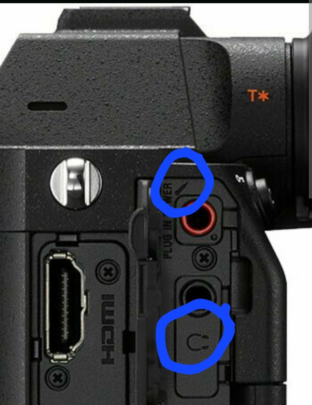

8 hours ago, Shaypanda said:
Where in your manual it shows the headphones and the microphone port?
Right here:

On my Sony cameras the microphone socket is red, and the headphone socket is not. And both are labelled with little icons - the headphone socket with a headphone symbol, and the microphone socket with a microphone symbol - the microphone one could be confused, but eh headphone one is pretty clear.
Which camera model are you using? Does yours have the little icons next to the sockets, and is the microphone socket red?

Dude, there is a symbol of a mic next to the mic port and a headphone icon next to the headphone port. Stop putting the blame on someone else and just accept you messed up.Screenshot_20230320_122207_Chrome.jpg.36a18c4b820721ef89fae1dc6e8e2b7f.jpg

You failed to look before plugging, its RED & has a Symbal.
