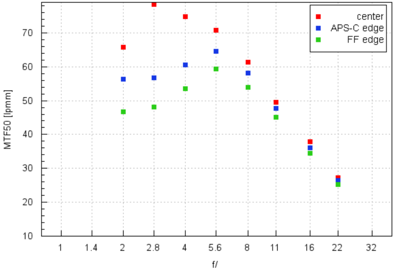

"do you not have a problem with furthering rumors on the Web? "  Firstly we need to straighten this out,  I have no agenda, seek no praise, condemn no one, seek only truth from a perspective of ignorance.  I am guided through the minefield of opinion by what appears to me to make sense, it is my opinion until other information comes my way that replaces/supercedes the current opinion.  It is my learning that most historically taught light theory is repeated dogma of very limited use in light of today's understandings. I am prepared to ditch all I hold as true at a moments notice in light of new information.  I read from many sources on the net,  Lens rentals, Phillip Reeve, Jim Kasson, Diglloyd and many more. I research and try things out almost every day, don't have a TV, don't collect books.  Do listen carefully to lens designers at Leica and CV whenever they give interviews.  i do look for patterns in peoples opinions.   Unfortunately I view peer review as an information control mechanism for those requiring influence with vested interests.
Thanks for that chart. It shows exactly what I've been saying -- stopping down 2-3 f-stops on most lenses -- even APO -- gives better resolution until diffraction takes over.  This is only one lens -- which shows a decrease in the center after a 1-stop reduction, for sure, but overall it's exactly what I said.  With that lens, the best results would be at f5.6, but other f-stops give good results too -- just avoid f16 & f22 unless you need the DOF for some reason.

The above chart is a good example.  It's not your lens, but most lenses show very similar results.  Even APO lenses (of whatever type) improve in resolution when stopping down -- until diffraction "takes over".

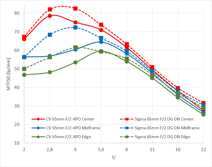

If it's pure resolution you're after, I wouldn't go blind on the 'sales term' APO. Usually APO lenses are marketed as top quality lenses (which they often are), but they're not sharpness monsters per se. In fact, the rather cheap Sigma 65mm f/2 DG DN beats the CV 65mm f/2 APO in this regard. Fortunately there's much more to a lens than just sharpness: I'm a CA hater myself and would gladly sacrifice a bit of sharpness to get rid of CA. In your specific case however, I don't expect (Lo)CA to be much of a problem as this is usually only a problem when shooting wide open.
(Image: I took the liberty of comparing LensTips MTF results for both lenses)
Edited by Pieter
