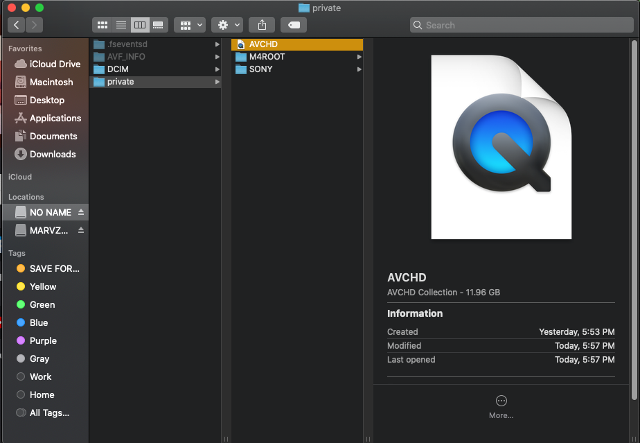

I figured it out.. really annoying. So above peopled mentioned its in Private\AVCHD which is correct but AVCHD is not a folder. it looks like its own file that opens with quicktime player. when you double click the file, it will open quicktime player with all of your footage.
It IS a folder, kind of. It's called a PACKAGE. Control+Click, right click, whatever click to get inside. For AVCHD you'll need to do this a few times. AVCHD then yields > BMVD then yields > STREAM folder which contains video.
(This will help anyone finding a mega huge file (likely a package) without a clue as to why it's so big, what's inside, and how do I get to the goods.)
