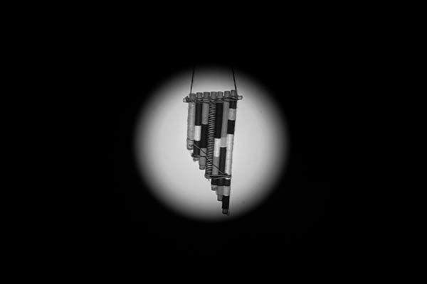

Could you please post a closeup of the naked adaptor only, plus one resulting image as shot with your setup?
Distance to sensor is not a problem. Goes together perfectly. B4 lenses (The broadcast standard mount were designed for using three sensors for red, blue, and green colors mounted behind a set of prisms that separated the light into three beams filtered for the primary colors. The imagers were originally electron tubes wirh phosphors that were scanned by electron beams. These were either plumbicon or saticon tubes. The cameras were quite large and power hungry to power the high voltage electronics. The tubes were later replaced by CCD imagers. Due to the prisms, the imager is set pretty far back from the mount allowing adaptation to some mirrorless Still Camera lenses. Sensor technology has evolved such that prism separation for colors is no longer necessary and sensors can achieve HD video on tiny chips as evidenced by GoPro Cameras

Thanks for your detailed answer, which - frankly - leaves me more puzzled than before.
I see quite a "gap" between your sample image, which apparently covers only a fraction of the sensor, with heavy falloff towards the outside and less than perfect sharpness on the one hand, and the superb 4K image quality that you seem to be aiming at on the other hand. How are you planning to close that gap?
On an unrelated note: the adaptor seems to still have traces from some kind of machining on its inner surface, which would eventually taint the sensor of your camera, if not removed.
The image  circle of a pro broadcast lens (even those monster lenses you see at football games is only 2/3 of an inch (17mm). That is all the sensor real estate that is needed for very clear ultra high definition video. I shoot HD video with cameras like that almost every week and it goes on giant screen Monitors in the hockey arena as well as out to cable TV.  The slightly speckled surface you see in the adapter picture is just the surface that the lens mount is locked to by a clamping ring. The inside of the mount is flat black. The upside of a small sensor size is that you can get tremendous magnification from a manageable size lens.
