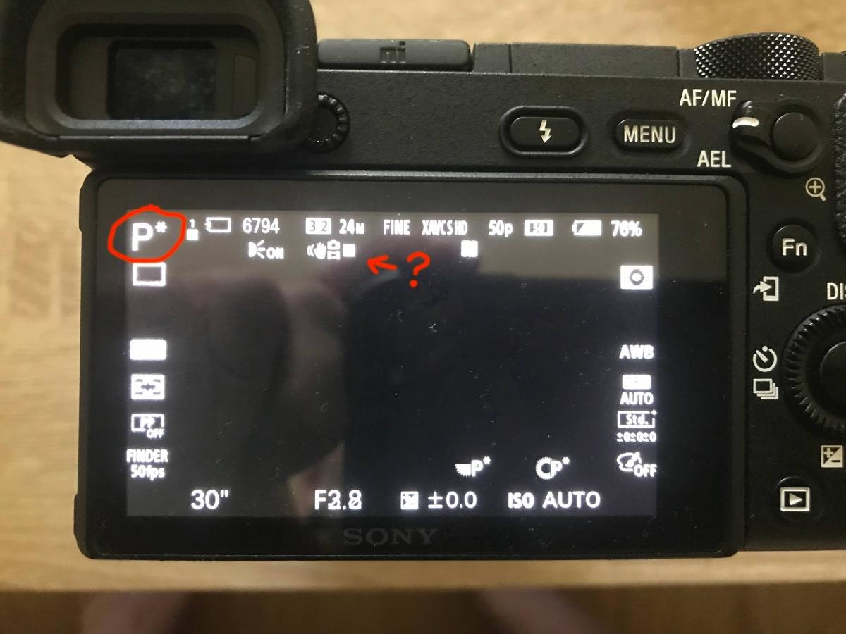

Hi there. I'm having some problems with my a6500 camera. I use recall 1 & 2 to shoot video - 1 for 4k and 2 for slow mo. I've used the camera for about half year without any problems, but one time, when I turned on the camera, P (priority) mode appeared on recall 1 & 2. I won't let me choose my exposure settings manually and I can't shoot any video with the automatic P mode. I tried resetting the camera to it's factory settings, but the problem is still there. I've googled every possible option and can't find the answer, how to turn off the P in recall modes. If there is anybody who would know, how I can fix this, I would be very thankful! I have a very important shoot coming in 2 days and I have to get this thing fixed. I added some photos, so you can see, what's the problem. Many thanx!
Have you tried the obvious...set the camera to recall 1 or 2, change the mode dial to M (as an example), then go to main menu and commit the new change to memory.  That should now have M as your memorized mode.

If it's any bit of a clue, altho my Sony interface is
different, I do think the asterisks indicate that you
are in AE lock ?

can it be the tedious shutter button stuck in the half pressed position?
