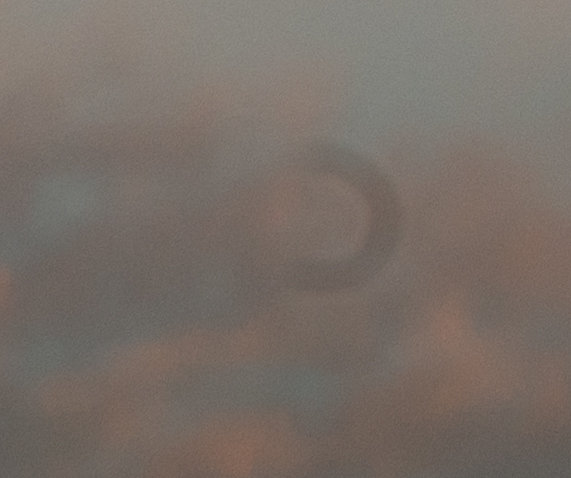

February 26, 20178 yr I have recently noticed an artifact appearing in the bottom center of my pictures. This only happens at smaller apertures F8 - F22. It is not dust as it forms almost a perfect 1/2 ring. I have swapped out lenses so it is not on the lens. I have done the self cleaning, as much as that does. I even looked at the sensor, I figured something this big would be visible, but the sensor appear clean. Given its size and shape I am not sure that a cleaning of the sensor would be helpful I have included 2 pictures. One is a blown up view of the artifact and the other is the full picture. You can see the artifact about 1/3 of the way in from the left and 1/3 of the way up from the bottom. The camera is still under warranty and I was looking for any advice before I have to pack it up and send it away for a few days or weeks depending on the speed Sony's warranty service. I would like any advice on how I should proceed. Thanks

February 27, 20178 yr I would carefully clean the sensor first, it almost looks like a minute moisture drop that dried leaving the ring. It's location as you look at the sensor would be upper left center I believe. Did you inspect with a loupe? Also, if you have another camera with macro capability, a detailed photo of the sensor might reveal what your eye cannot see.

February 27, 20178 yr Author Thank you everyone. My biggest worry was that there was an issue with the sensor in that the area was so large and mostly circular but @tinplater had a very reasonable explanation. Being a wuss, I am taking it to the local reputable (they have been around since 1938 and have done good work for me before) camera shop for a cleaning. Thanks again.
March 2, 20178 yr Author Just got it back. I was able to see it in the view finder, but now it is gone completely. I think it is fixed. Gonna snap a shot and bring it into Lightroom tonight to get a closer inspection. But so far B-E-A-utiful. Thanks again for your help.
