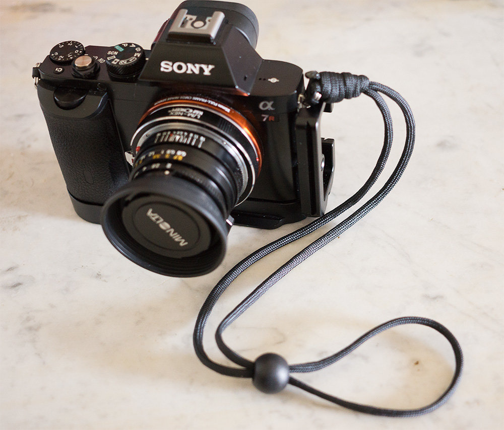

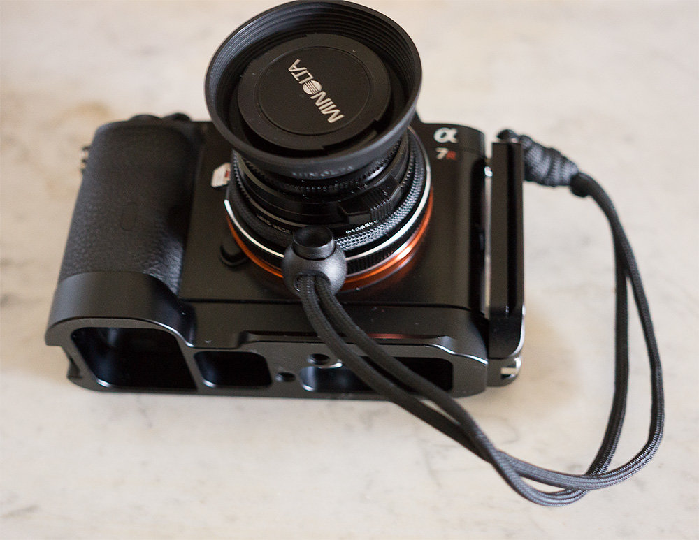

A lot of adapters out there, and according to many even the ones from big manufacturers, suffers from mild to severe light leaks if used under specific conditions: daylight, long shutter speeds (seconds), even more so if on a tripod (shooting handheld the hand often shades the lens a bit, and the shutter times will be faster anyway).
Before rushing out to buy the latest overpriced Novoflex or Voigtlander model like I was this close to do (supposedly the only two brands that, IN THE LATEST MODELS ONLY, do not suffer from this) you could try my solution.
The pictures* speak for themselves. The nice thing is that this solution doubles as a neck / wrist strap as well. If you intend to carry the camera with it, and not just eliminating the leaks, you will have to be careful how you tie the knots and be certain to use "paracord", a kind of rope that has a 200/250Kg breaking point and it is used, guess what?, to tie the parachutes.
*sorry for the crappy pictures, I was in a hurry!

Jokes aside, I've seen these leaks only with daylight shining exactly on the lens-adapter junction and shutter times from 8/15 seconds and up, so it's not a common occurrence for many people (but unfortunately it is for me). Have you tried yours in these conditions?
BTW, the Leica M is the one with almost no leak at all, while the absolute worst of the bunch is the one for Contax.
