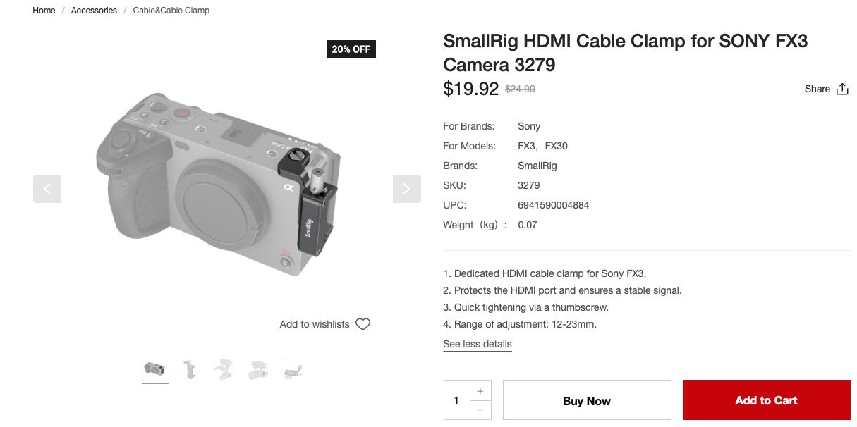

Regardless, cage or no, I never plug any cable into a camera without some kind of strain relief. Twenty bucks from SmallRig or seven from Tilta (lousy design as you need your toolbox handy to affix it) keeps it out of repair sick bay to get it fixed should it get out of whack from not using one.
