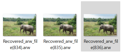

I could recover the files from the trip but most of the lossless pictures (which are ARW when extracted by Recuva and MiniTool, but SR2 when extracted by PhotoRec, no idea why) are corrupted. They seem ok in appearance (the thumbnail in Windows Explorer seem perfectly normal), but when I try to open them I most of the time see some weird pink strip or cuts both in the default Windows Pictures and in Lightroom - some of them are thus only minor corruption (like change of exposure or rotated picture).
I posted attached some example to give you a hint about the issue. Also, old files (pictures from older trips) are them recovered perfectly well.

Sounds like a broken SD card. Too bad, but this can happen, unfortunately.
The preview picture is just an embedded low resolution jpeg. Your raw example definitely looks corrupted.
Does your camera correctly create pictures now?  If so, it's just an SD card gone bad.  That happens -- and there are many reasons.  Some people try to get their pictures off of an SD card ASAP.  That's about the only way to avoid this problem.
