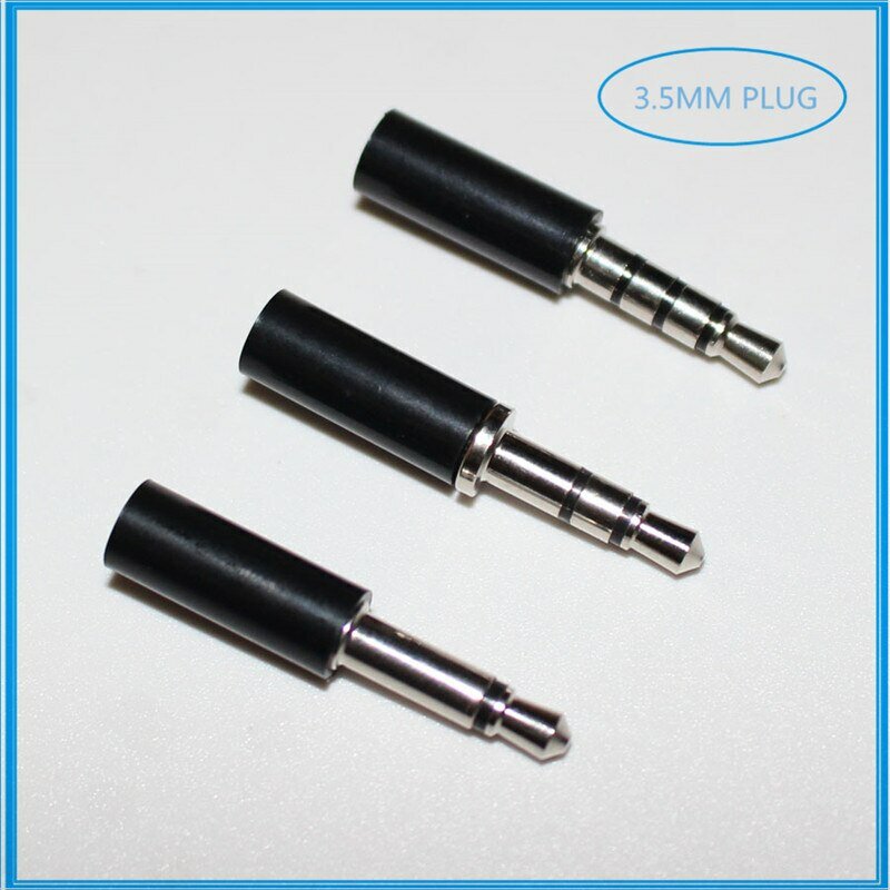

I had the same problem and puzzled over it for ages and looked to this forum, but no luck. As it was a new camera with a working internal mike, I figured the problem had to be the jacks.   After some trial and error I got it working. The jack going into the mic socket must be a two-pole.  Also if using an extension chord it must have a two pole socket and jack too.  If you are using a wireless microphone check that it is a two - pole jack that the transmitter you use has.   Hope it works out for you , drove me crazy for a while.
FYI the jack in the middle is the two-pole the other will simply not work I was using three and four pole before.
