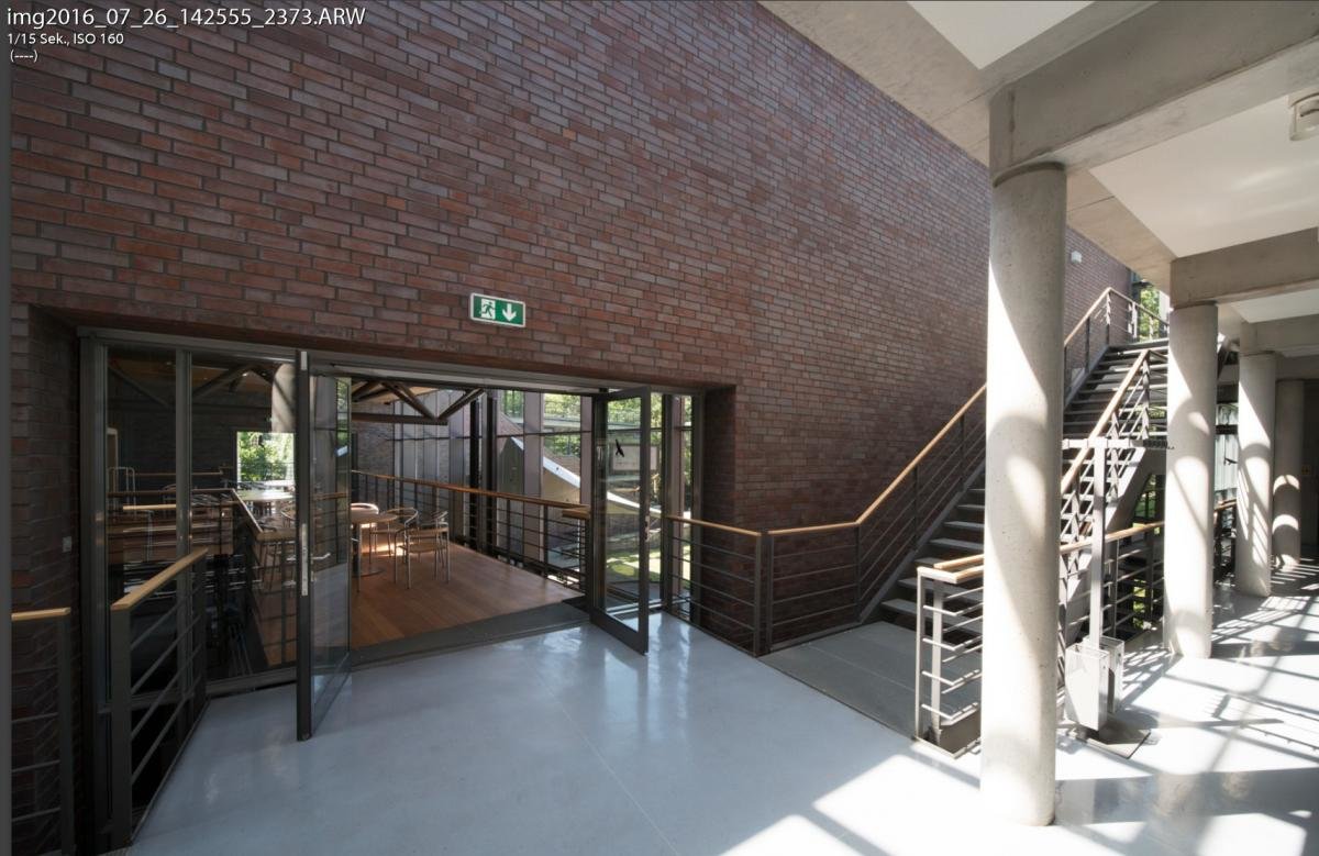

A few days ago I got a comment in flickr, that my title of the images, saying the LAOWA 12mm f/2.8 ZERO-D, is wrong, the EXIF says Voigtlander Heliar-Hyper Wide 10mm f/5.6 ???
I checked all LAOWA images and all had the wrong Voigtlander Heliar-Hyper 10mm in the EXIF!!! The same wrong EXIF in the article here at SAR.
Some images with the LAOWA show the wrong Voigtlander in the EXIF, but no aperture
The images with the Voigtlander show the correct Voigtlander in the EXIF, but with aperture!!!
I developed the images again with my C1 for Sony and with the new LR Ver. 6 and with ACR and Photoshop CS6 and with Affinity
all show the same wrong lens in the EXIF.
I attached 3 screenshots from LR6, you see the EXIF info in the upper left corner
laowa1 shows the image with the Laowa 12mm, the EXIF shows only the exposure time is shown, the lens is --- and no aperture

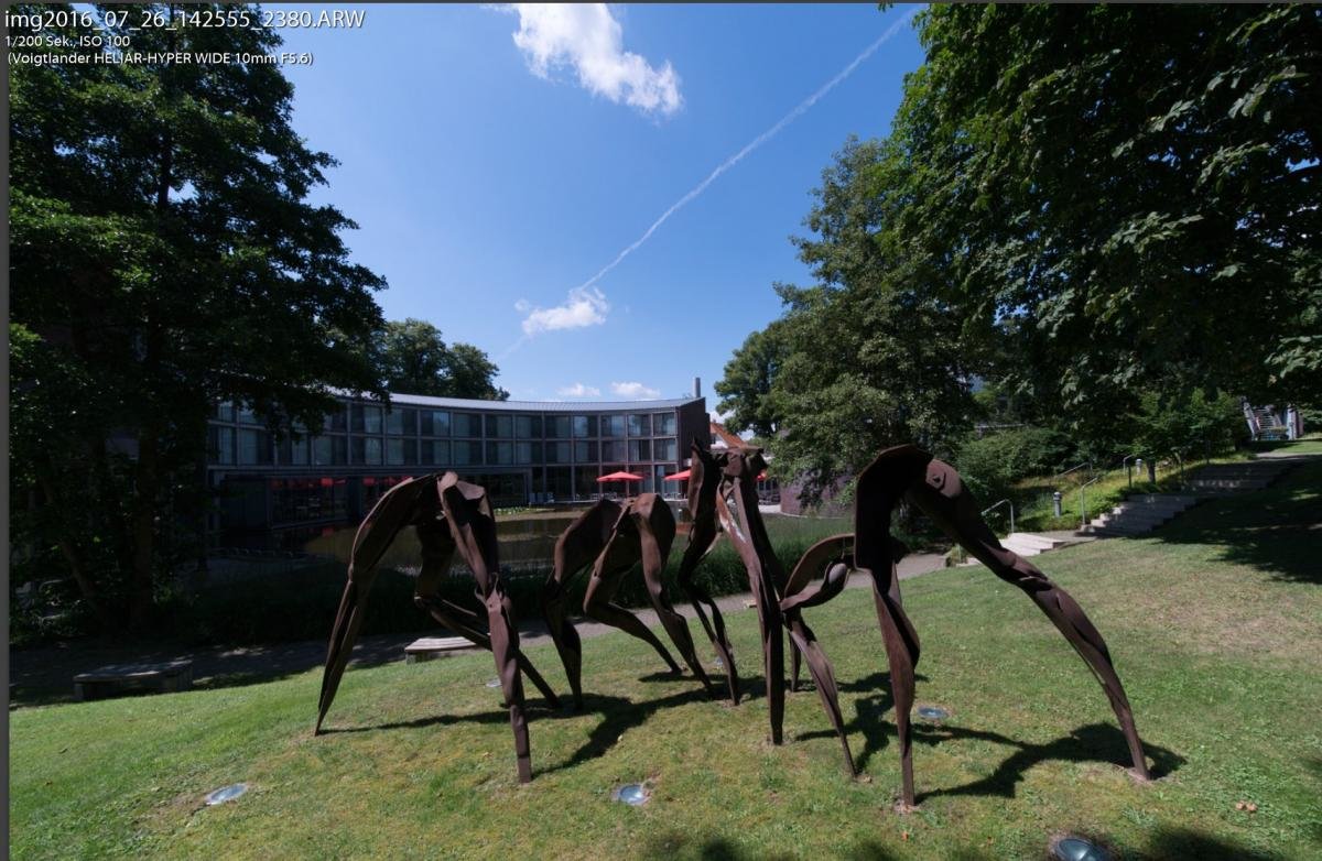

I changed the lens to the Voigtlander 10mm
laowa2 shows the image with correct lens info Voigtlander Heliar-Hyper with exposure time, the complete lens info with 10mm and the rest in brackets, and aperture
I changed the lens back to the Laowa 12mm
laowa3 shows the image with the Laowa 12mm, now the EXIF shows the exposure time, but only the lens in brackets without the 10mm in front and no aperture (of corse, no electronic connection)
