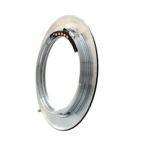

I have a Sony a100 camera body that has served me well. I just bought a vivitar 500mm telephoto lens with a 2x adapter. The lens has an adapter that connects it to my camera. The fit for the camera is perfect. No movement at all. The problem I am having is that the camera won't recognize the lens. It displays a message when I try to shoot that says "no lens attached". I have been searching in the camera to trouble shoot this. Please help, any advice would be appreciated.
