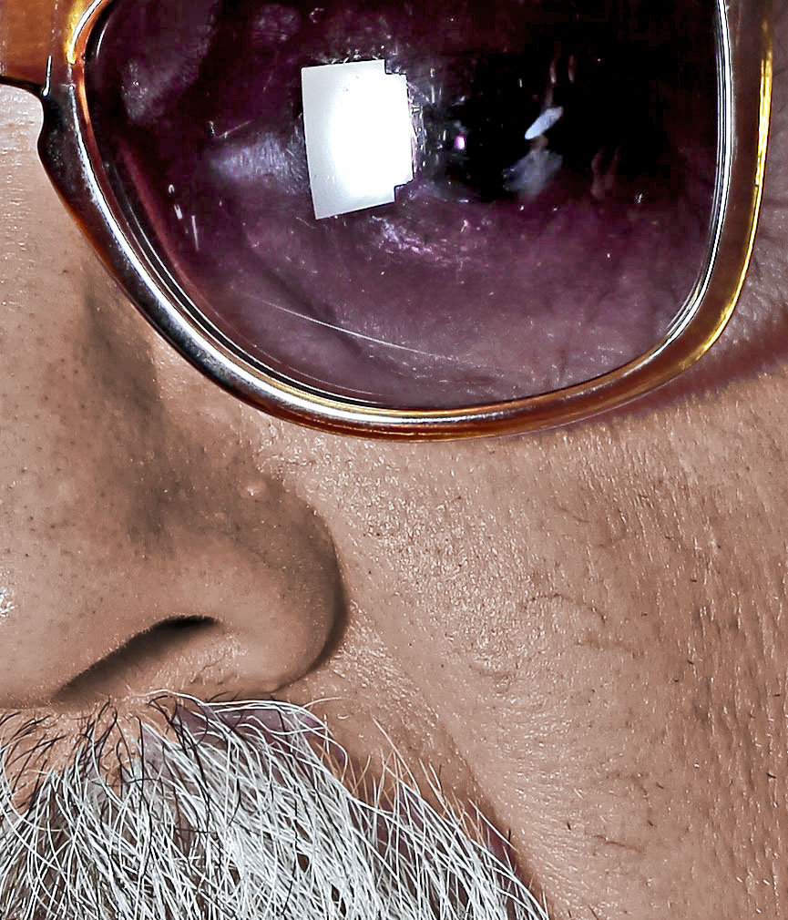

As to small apertures noticeably destroying sharpness, really
now ....  Here's f:13 cropped to less than 1/4 of the frame. It was
originally a standard "Head Shot" :
If someone says this image is technically less than geekishly
optimally soopersharp, well and good, but the point is that no
user getting results like this would ever be authoring a thread
about never getting sharp pix from his camera !
