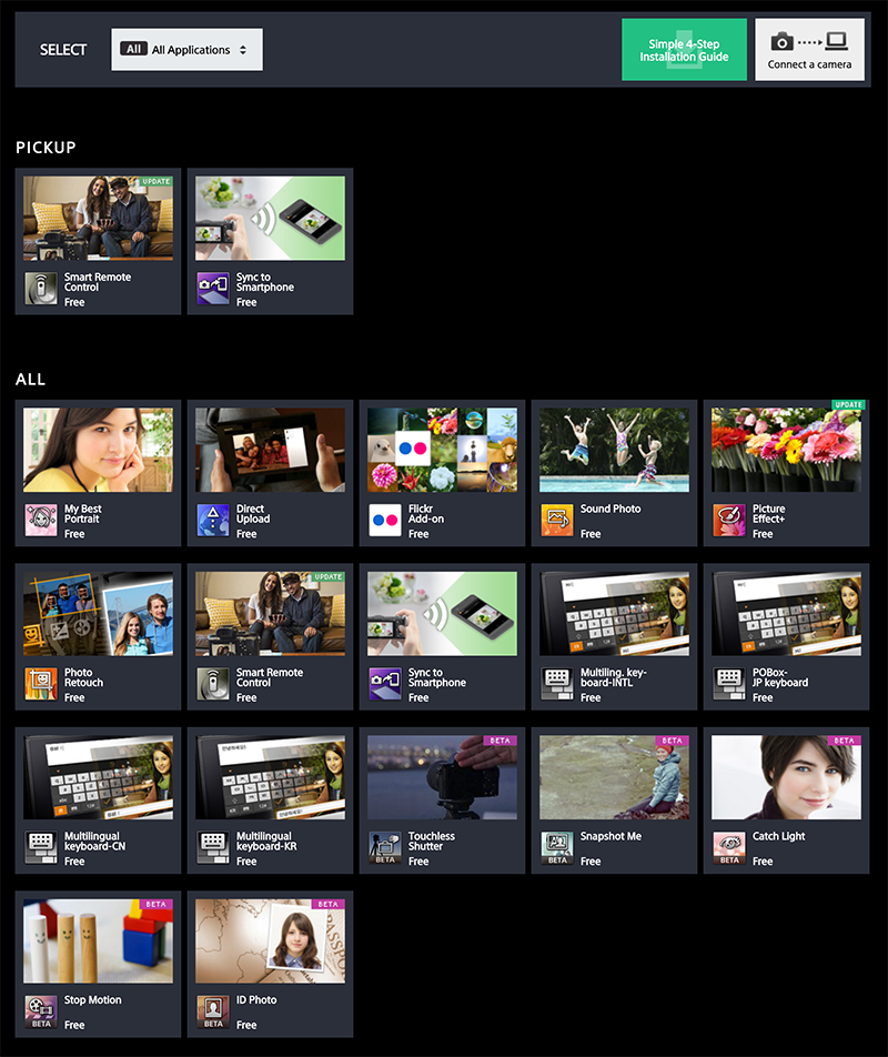

Still can't load it on a a7r2
Hi OldSwede, I still can't see any time lapse app when I click the link you gave me.
Attached is still what I can see.
Strange, because it's a link to this site...
Hi OldSwede, I finally found why I can't see those apps... not applicable in our region, middle east (I don't know why).
Thanks anyways for your help.
