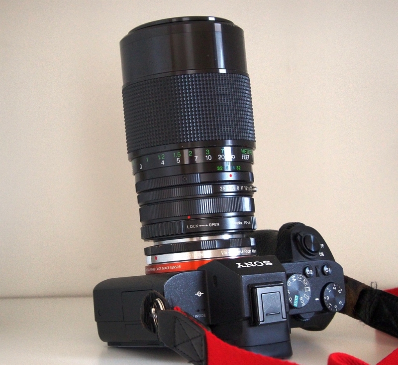

Yep, the idea was that it would be say an OM lens, then an OM to Leica M adapter, then a Leica M to Sony E helicoid, which mounts to the camera. I'm no stranger to stacking adapters. Currently, I have an EF to E mount adapter, to which I then mount the lenses I used to adapt to my 6D. Anyway, addicted2light's reply answered my question as to whether this idea would work.

Yes, it's my daily use ;)
Leica M ist my master and I stack every legacy lens (Minolta MC, Canon FD, Leica R) with M-Adapters to it (except Leica M, which ist native for me :D ).
Great! So there's not too much wobble when mounting an SLR lens on top of the helicoid adapter?
My biggest lenses are Canon FDn 300 and 400mm; but I use this with my Monopod (of course) ;)
All other lenses 'till 200m aren't a problem w/o 'pod either ...

Thanks for the input! I decided to also look up the specs for the lenses I would use with this combo, and all of mine are lighter than the Summilux 50, and the overall length including the adapter is pretty close. Just ordered a helicoid adapter as well as an OM-M and CY-M adapter.
I also stacked my heavy 1:1 Kiron Macro lens (FD Mount to Leica M) w/o any problem.
This Voigtlaender adapter is very solid!
Wish I had the budget for the VM-E adapter! I ended up ordering a cheap $30 one, and will see if that does the trick. I don't plan to mount anything that big or heavy to it, so it's hopefully sturdy enough for me.
