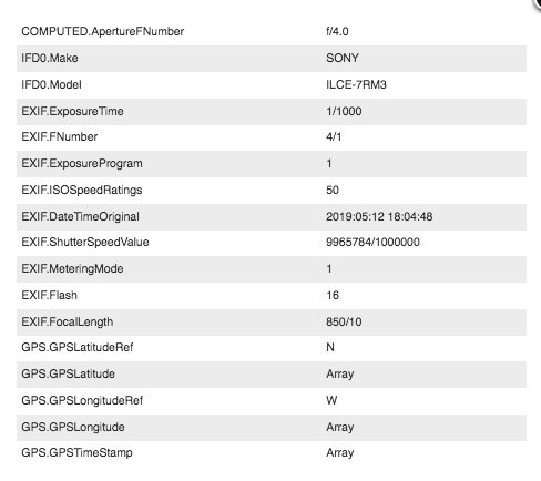

I have tried flexible spot, but it can’t seem to keep up with the fast moving aircraft. It loses focus. The details for the photo I posted are:
ISO 50, 85mm prime, f/4.0, 1,1000 sec.

Thank you!! Ironically, for this specific pic it was set at centre. I don’t even know why because I always use wide. The metadata for this pic is:
ISO 50, f/4.0, 1/1000, 85mm prime.

By the way, iso50  is not meaningful , as the base iso of the cam is 100. It is best to keep your iso at 100 and increase your f number for more depth of field.  Better still: use iso auto and iso auto min.ss at 1/1000.  And use aperture priority, f8 or more.

I think ISO still confuses me. I just thought the lower the ISO, the less grain and cleaner the photo.
