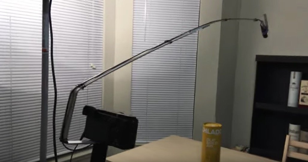

Nope it was a mechanical and possibly heat related thing. I had a long aluminum bar for a small boom mic clamped between the tripod and the camera base. Small movements would cause the mic to bounce very slightly and this was somehow causing the focus issue.
The bar must have been slightly flexing the camera? Took a while to find out the cause.
phil
Yeah took three days of testing to track it down. It did seem to get worse as the camera warmed up. I confirmed it was not electrical by unplugging the mic and the big lights. It was not visual as I lifted the mic boom well clear of the FOV of the lens. Removing the mic boom solved it.
I am 99% sure some mechanical pressure was causing an electronic issue inside once the camera was warm. Stepping through the frames you can see the blur across half of the image (1/60th shutter speed) where the rolling shutter captures the change. So the focus as changing very rapidly. Nothing was touching the lens.
At least I can get back to shooting. See pic below of the problem setup

I was using a mix  of Sony and 3rd party so could be. But in my case it was definitely related to pressure on the tripod mount combined with heat.
Try testing not on a tripod (no tight screw pressure). I did ultimately switch to manual focus for my needs.
